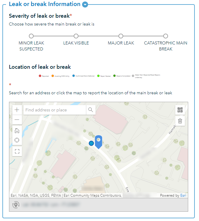

I have a survey, accessed via the browser, that includes a geopoint question. For the basemap I use a custom webmap that shows existing nearby survey results. Is there a way to include a Legend with this?
Currently I must manually make an image of the legend and include this in my media folder. However, if I ever update the webmaps legend this must also be manually updated.

Currently the Survey123 web app and field app both map questions (geopoint, geoshape, geotrace) do not support legends.

Good idea to add the legend as an image as a workaround.
