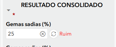

I'm developing a form in Survey123 Connect version 3.19.104. The form has several calculations. I would like to know if there is a tool in the survey, similar to Excel, for conditional training using a set of icons. For example, if the result is between 6 - 10 the icon will be green, between 4 - 5 the yellow icon and below 4 the red icon. If there is another way of visually representing the result, for example, instead of an icon appearing, the color of the text or the field will change according to the result.

Text is probably easier than an Icon e.g.:
https://support.esri.com/en-us/knowledge-base/how-to-change-the-text-color-display-in-arcgis-survey1...
If you really want an image you could:
  1. Add three note questions (leave name blank, so it's null)
  2. Add a .jpg to media folder for each note and put name of image in media::image
  3. Apply relevancy to the note based on the conditions
https://community.esri.com/t5/arcgis-survey123-blog/surveys-with-style/ba-p/898115

ChristopherCounsell
MVP Frequent Contributor
You could also have a select_one question with images for labels and have it calculated but you'd want to explore which question appearance looks best, maybe likert
