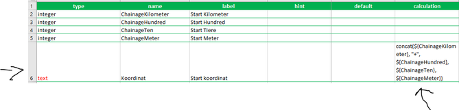

I have written a calculation in my Survey123 under the calculation coloumn looking like this: concat(${ChainageKilometer}, "+", ${ChainageHundred}, ${ChainageTen}, ${ChainageMeter})

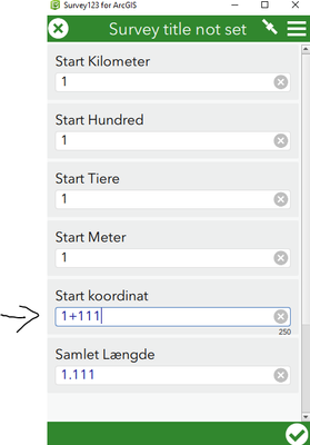

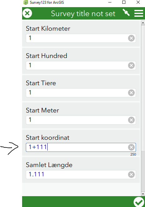

It combines the integer questions and adds a "+" between them. The result is written to a text question. In the Survey123 app it works perfectly, and I can send the answer, however in the attributetable when the answer is submitted, the attribute is empty. Any suggestions to what I can change to make it work?
Picture: Setup in Excel
Picture: Look in the Survey123 app.

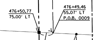

I would assume it's for some kind of road-related thing. "Distance along the road" in highway plans is often shown in that sort of format.
