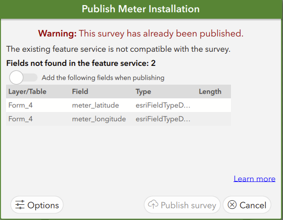

Hi,
Version: Survey123 Connect 3.12.232
We are trying to extract the latitude and longitude from a geopoint question of published survey. We followed the recommendations of this blog, from 2016: https://community.esri.com/t5/arcgis-survey123-blog/pulling-data-from-geopoint-questions/ba-p/896838. We tried using the hidden question type with pulldata to extract the x\y, and using decimal question type, pulldata and hidden appearance; in both cases we are getting the message that "The existing feature service is not compatible with the survey".
The survey was created in 2020, and the blog is from 2016. Why the addition of these questions is raising this warning? That we understand means that if we publish the survey a new service will be create and the old data will be lost.

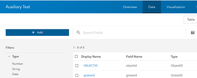

jcarlson
MVP Alum
Just go to the feature layer and add the fields using the name and type from your XLS form. Then when publishing the survey, it will recognize the existence of those fields and not prompt for re-publishing the service.

Billy
Hi Josh\Doug,
Thanks for your answers. We need the lat\lon as separate fields in the database because we need it for another system when we export the data as csv.
Regarding the addition of the fields, Survey123 is offering to add the additional fields to the feature service during the re-publishing (see the publishing dialog image). Our concern is that we have added new fields in the past and never received the warning "The existing feature service is not compatible with the survey". Our understanding is that this warning means that if we re-publish the survey with the changes then a new feature service will be created and the old data will be lost.
jcarlson
MVP Alum
You need to add the fields from the AGOL Content page, not via S123.
I don't know if that message and overwrite option is a new addition, but I have only seen it when adding fields to the original form in Survey123 Connect.
