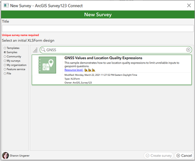

Check out the GNSS Values and Location Quality Expressions template on ArcGIS Survey123 Connect
I have not tried using a similar setup with an existing feature service....yet!
