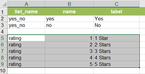

Publishing the attached survey to a clean, newly installed Portal 10.6 server gives the following error:
The problem seems to lie with changing a select_one field's data type to esriFieldTypeInteger even though the select_one points to integer choice values:
If I don't change the data type or change it to esriFieldTypeString then the publishing error doesn't occur.

Select_one question types are text only by design, you can not change them to be integer, hence the mismatch error when trying to publish. If you would like to use calculations and other integer based queries in your survey, you can set the bind type (not esri bind type) to be integer, and that way the app will treat it as an integer, but the data will stored be stored as text in the feature layer.

Philip Wilson‌  I am using a spreadsheet to create a survey in Connect, and I'm having the same problem. I need two Select_one questions to be numbers for calculations. The schema I received (from someone with Esri Canada) has the esri bind type as Double. Should I leave that one blank and make the blind type decimal? Or set the esri blind type as String as well? Thanks!
