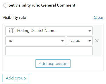

Hello,
as far as I am aware there is no way to clear a form but I wondered if I could create a rule based on a field? I have created a "Single select" field and thought I could perhaps "Set rule" to clear the populated responses in some other fields?
Thank you

You can use a calc of '' for empty string.  You can end up with the little cycle icon though so test it.

The image is of the Surveys Site filter, but the question is phrased like they are looking for a way to "reset" a survey in progress?
Assuming the later, if your select_one is empty, you can add this to the relevant column of anything you want to "reset": ${my_select_one_name}=''
Anything that is hidden by a relevant column expression is essentially "reset to default".
