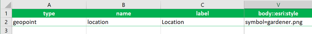

  • In the body::esri:style, for your geopoint question, reference the PNG file as shown below

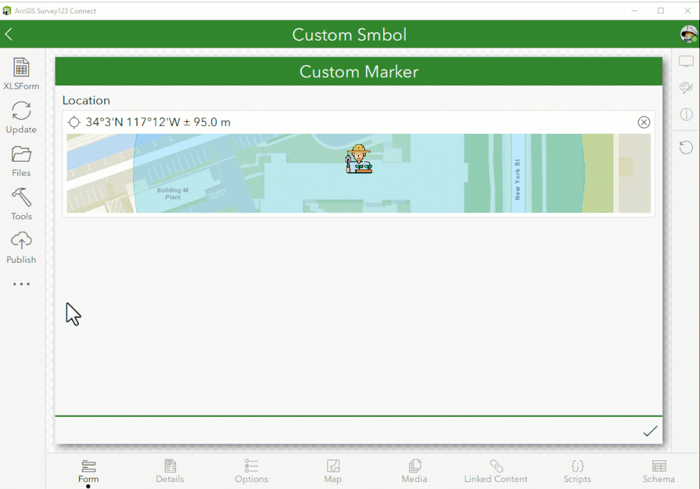

  • Download and test in the mobile app

  • The above will work in the mobile app. Will not work in the web app

  • The PNG file is placed horizontally centered at the location but vertically, it uses the bottom of the PNG. If you want to center your PNG exactly at the location, use the x y parameters as follows:
symbol=gardener.png?x=0.5&y=0.5
