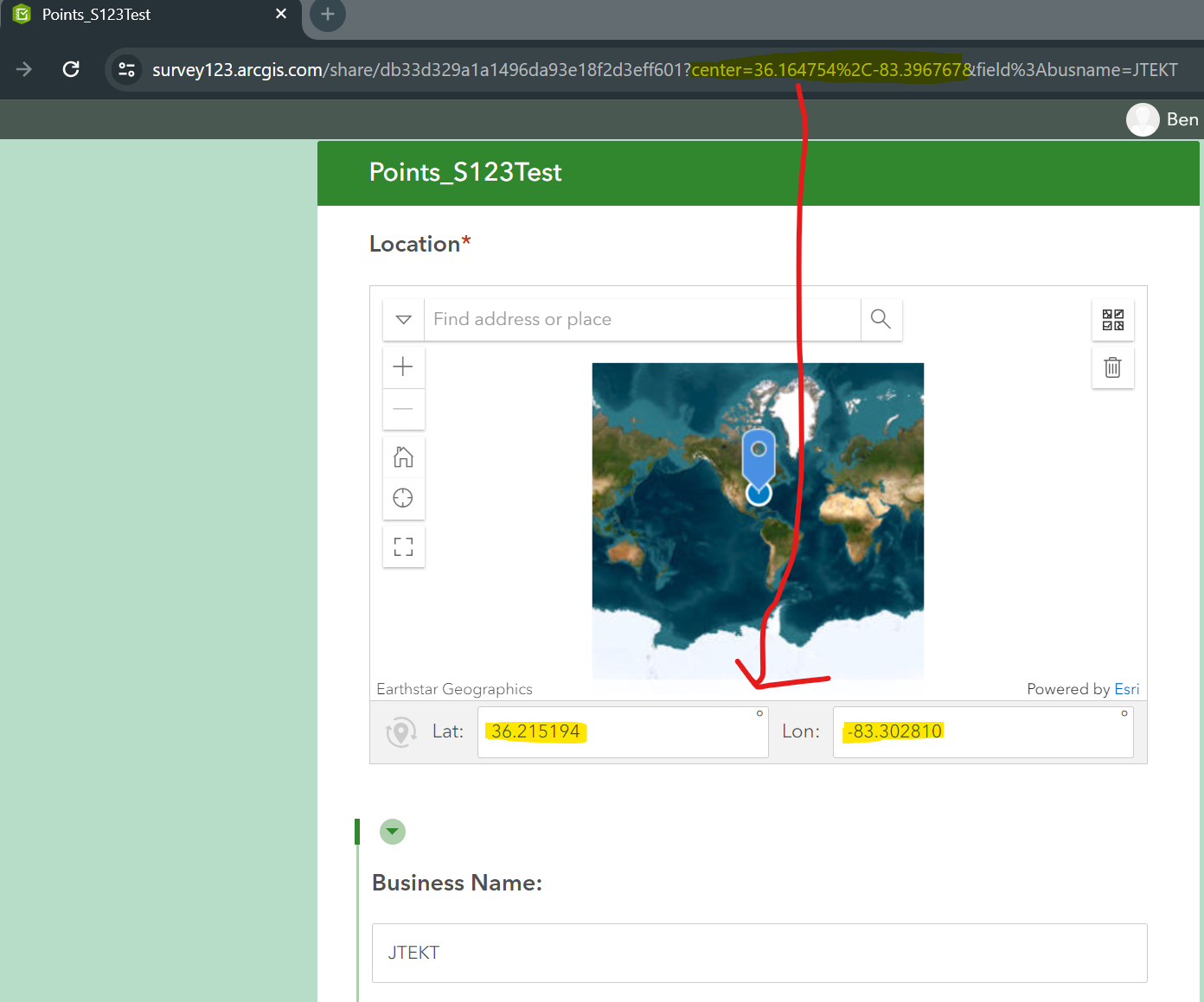

I have previously created workflows where URL parameters are passed from a popup link (in web map or Field Maps) and launches Survey123 field app, pulling information like coordinates, address, and business name. Perhaps something has changed recently or I am missing a step, but I am trying to create a similar workflow in the Survey123 Web App and the center parameter is not centering the geopoint question.

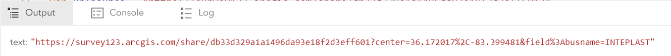

I have seen other posts about using URL Encode to format the text before constructing the URL, which I have done. The coordinates (derived from 2 Arcade expressions in the popup) are being passed correctly but the geopoint question is not centering on the coordinates. Is this expected behavior for the Survey123 web app or have I missed something else? I also saw a mention of making the geopoint question required, but that has not remedied the situation either.

Returns:
URL and Geopoint question center don't match:

Took forever to find where I did this...
For the geopoint, set default to null
EDIT: I don't have required set for my geopoint, but I have seen others say that it may help.

bbaker_tngeo
That solved it, thanks for the advice!
