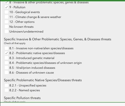

I just updated to version 3.11 and am trying to implement a cascading select_multiple using choice_filters, which was added with this update (https://doc.arcgis.com/en/survey123/faq/whatsnewsurvey123.htm). However, I am having some problems. I have three levels of select_multiple questions. As an example, if options 8 and 9 are selected in question 1, two more questions appear with options 8.1, 8.2, 8.3, etc. and 9.1, 9.2, 9.3, etc. Then, if 8.2, 9.1, and 9.2 were selected in these questions, more questions would appear with options 8.2.1, 8.2.2, etc.; 9.1.1, 9.1.2, etc.; and 9.2.1, 9.2.2, etc. (see image).
Example of level I, II, and III questionsExample of level I, II, and III questions

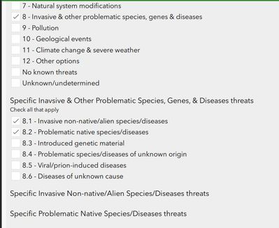

In practice, going from level I to level II questions works. If I select three level one options, three more questions appear offering level II values related to each level I option selected. Then, if I only select ONE level II option in a question, the level III options appear (see above), but if I select two or more, the question labels appear, but not the options.
Two level II options selected causes an errorTwo level II options selected causes an error

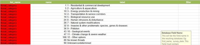

Here are the choices in the choices sheet for level I threats:
Level I choicesLevel I choices

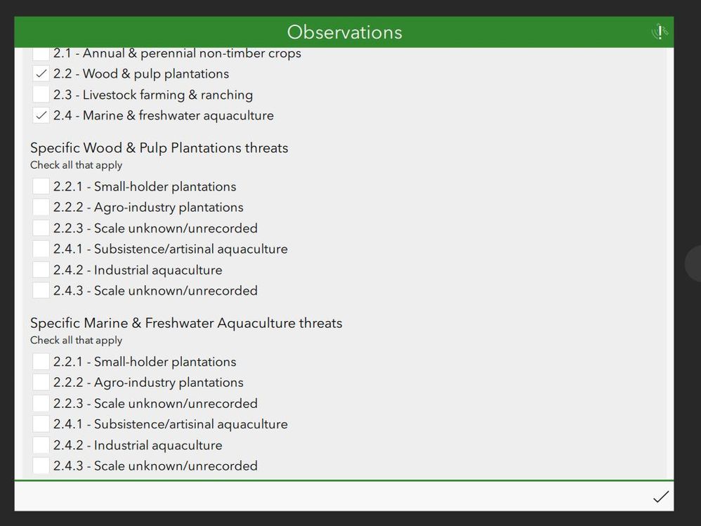

Hi @Jim-Moore . Thank you for your response. I had tried one regex formula, and it didn't work. However, I tried this one, and it does, except that it shows all level III choices for each level II choice selected for each level III question that becomes relevant (see screenshot below).
All level III choices shown for each questionAll level III choices shown for each questionGetting much closer.

As you're seeing, if more than one choice is selected for the level II select_multiple, the regex() will return multiple matches. For example, if threat_invasive has answers 8.1 and 8.4, the value stored for this question is '33,142', so all choices matching 33 and 142 will be returned. You want to return the '33' choices only for one question, and the '142' choices only for another question, so I think in this case the solution is to use separate choice lists for each level III option. Because each choice list is discrete (i.e. the level III choices are unique/static for each level II choice) and displayed in its own question, there is no need to use a choice filter. You've already implemented relevant conditions to control which questions (and choices) the user sees.
If you wanted to have only one question for level III and dynamically adjust the choices presented in it from a longer list if all potential level III choices, a choice filter would be necessary.
