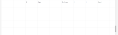

It seems that my repeat count is overriding my relevant and giving me a blank repeat row.
I have my relevant and repeat count like this on my begin repeat (relevant first).
This says if it is a X transect to not show this repeat at all.
 I am getting a phantom all blank row in the repeat on X transects.
I also tried to add a statement to set repeat count to 0 on a X transect but I still get the phantom row.
if(contains(${Transect}, "X"), 0, if(${Transect} = "K" or ${ThalwegType} = "Core", 1, ${MidThalweg}))
Using 3.12/3.11
Any ideas on how to get rid of this phantom row?  Or is this a bug?

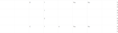

I have more info now.  It is not just happening on repeats with a repeat count.
It seems to happen when I have a relevant statement on the begin repeat line.
Weird thing is that any Note in the repeat will still calculate and populate the service.
and
But if there are no Note fields in the repeat then the record is a completely blank row.  In this form this section is just for one state so I am getting lots and lots of blank rows.
Hopefully this one is on the list soon.  I will have hundreds of blank rows.
I tried setting repeat count to 0 and I still get them.
I also tried setting appearance to minimal but then this is a different bug where nested repeats ignore the minimal appearance.  I posted this one back to Ismael awhile ago when he wrote on it to say nested do not work but never hear back.  I hope this is logged.
