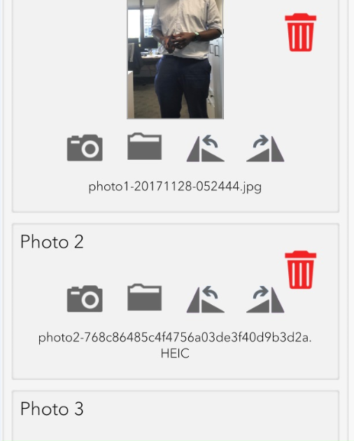

After updating my iPhone to iOS 11, I have noticed that my photos are in .HEIC file format rather than the usual .jpg format.
But, these files cannot be uploaded via the Survey123 field app.
To get around this, I have reverted my camera settings to take .jpg rather than .heic
But, it would be great if this could be fixed ASAP. As, most of my clients are on ios11

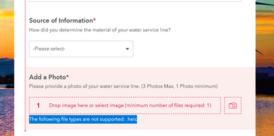

brward
I tried it just now and it has the same issue of not converting an HEIC to a jpeg on windows as well. It does give the error code of 'The following file types are not supported: .heic'. I made this survey through connect on 3.19 version FYI.
