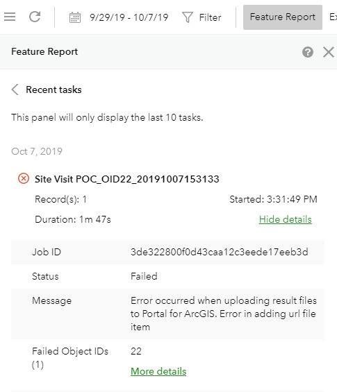

Recently we have upgraded environment to 10.6.1, it generates the Feature Report sample templates, but again when I try to generate report for selected record I am getting error ""An error occurred when uploading result files to Portal for ArcGIS. Error in adding URL file item"
Below is Enterprise detail :
ArcGIS Enterprise 10.6.1
Survey123 version 3.6
Portal for ArcGIS Account : Domain\AD account
I checked Portal log and log is below "Read timed out".
Failed to add item '8c3c1af49486497ca01c0cc005afa435' from URL 'https://featurereport-prod.s3.amazonaws.com/9cc92fdd07d34024adb8ccbbfc2fb8c6/Site%20Visit%20POC_OID23_20191007153617.docx?X-Amz-Algorithm=AWS4-HMAC-SHA256&X-Amz-Credential=ASIA5SCZICL5RMU5QMS5%2F20191007%2Fus-east-1%2Fs3%2Faws4_request&X-Amz-Date=20191007T123705Z&X-Amz-Expires=900&X-Amz-Security-Token=AgoJb3JpZ2luX2VjEIv%2F%2F%2F%2F%2F%2F%2F%2F%2F%2FwEaCXVzLWVhc3QtMSJIMEYCIQDdLhJH3FBXdIzf3WUAjRhlQmbYbnxyuTcmROC7wQQUSwIhAPizHZrMzoBv4b0Yiuc3BZd8G5OsTe1G97QNH%2FWkVXK%2FKpkCCHQQARoMOTMyMTk1MDc4OTA3IgzLMTzOtgaTaukTE7Iq9gH39sbkySGKUbNr%2B%2F58nZCAew49OuSfsmNyTIZqXo2aXOjh%2FsEkgMSOdudInUwXnaFZrGRFW5IDpYVT%2FmrxtcpCirSawBLbsgTQwR070uz5FtbVVFzoOc7xmJolklIkxLcm473aOskkZtn3BnXT14jGFbUPuDN6oGeZWnrMDbQw%2Fknz2vJBVHOsWUtqC%2BBcpZHhx4cuIwk7RkAOHAOSYn%2BB%2B5bJSvV35y5h2enVT068z0koLFjzKo%2FGlPrTnrjiSV5BroiBFrLYSwelbqYqxZXGhy%2F5bxZxkNc4GAPZ%2Bip49Vz5v6H3c63tYUa5MEUQXwj%2B3Oqp%2FrEwsLPs7AU6swGpARdphWBhyqdMcXmVoWAE5bW20hDGxikComUNrmYlAbg8FchNoIdTG4Hih6zbmDD9AE65Rs1auL81pxbfuYBZOF94AxXv5ELzgUCJsmai0a8jUWbH9DdDjgMDTE3RXyYw%2FAvOeNsA1DHR5shaDSnBkL5e6A2XmN1VmAVVbCNUQyoJEZ9QfI4%2FFyPbvPnleADQkRY6jOe%2BNSQxodiwsNbcEKgfSpRrTu7jr9bIPL0lS7fRGQ%3D%3D&X-Amz-Signature=32908238638dd28060d3c13260348342299c3b340c22ba8e31985ff2f44172c9&X-Amz-SignedHeaders=host'. Read timed out

ChrisPedrezuela1
We have the same issue with our public facing 10.6.1 portal. It does not use IWA, were using built-in portal accounts.
ailed to add item '59708e9f2bd0478a9b9b65bd21bc6b16' from URL 'https://featurereport-prod.s3.amazonaws.com/1d4d8ada45f64ed1a22752f3ec6bb4f9/survey123Test_2%20records_20191018142644.zip?X-Amz-Algorithm=AWS4-HMAC-SHA256&X-Amz-Credential=ASIA5SCZICL5RN2F74DE%2F20191018%2Fus-east-1%2Fs3%2Faws4_request&X-Amz-Date=20191018T012728Z&X-Amz-Expires=900&X-Amz-Security-Token=AgoJb3JpZ2luX2VjEIr%2F%2F%2F%2F%2F%2F%2F%2F%2F%2FwEaCXVzLWVhc3QtMSJGMEQCIBOyTCxFPKKTtRt2m43T027Y0jZDs%2Ba3aUS2vVd7ABv1AiBgPw4GEpAtFQUhloZNBtju6P4W3ul1K%2BCI90UOmFF3CyqiAgiC%2F%2F%2F%2F%2F%2F%2F%2F%2F%2F8BEAEaDDkzMjE5NTA3ODkwNyIMY2iQcO1od2ybHmWoKvYBfUfcZlmK2DlB3SSRoxVVv1Jfx%2Btnp2Q27FypWNJBTw4MwvHU7myKHol%2FPwpdpO67iaoQMGGpv5bUDdcTPTekdMkxL0m77em7DEHZF%2BTOgd0dWTW0ANDzfx4V7%2B9YMAKi3q4uoefP2TuSL3Xxc0kAXWQiEQsdMW56Hm3gWWsgxIeYNyOc14kbVsX9u2oc8qzIfaLCnvaXo3HnHnP1HWvEocG6XID3XDmFX6cKW2X3oU1%2B2l74%2FUTRVxdODwtHmFgDW1TwO3XHKr1G1O4iJ80vRIrRSbY9hINx8Qon9UXlRsDAt3RD7ivfUsimFQSYhFGxtJH%2BRzh3MLGlpO0FOrUBVjU1GmeYRIOWwjpa4Xd9zqYv3WJXCR8nmxHt%2BBzmqBUKyVQ30P2koqV8QZFA%2FccBGYnD8UKotiZ5XD5x7QK4AkjV%2F1i%2F4PQwNldn7T6fOQEekeQ9Vq87E8ttHQG5P3%2Fo7XBmJQiYFjsg1blYFgE%2FFgsSQb8jJHHzRtI%2BNp5JIHMaM%2FFcevdRfZSa94mutcqwT%2F7%2F424hMj%2BVY%2BX6BLsTKxzY1FgKxpS3Rob9BFAiH6aCjFBsOw%3D%3D&X-Amz-Signature=8a238c1b7d25178734f74750a5258261aefca62be84e9dcfdfeb3ddb3379e4c1&X-Amz-SignedHeaders=host'. Connection timed out: connect

Thanks James. Do you have any ideas why we experience "connection time out"? Our portal, which is hosted on our local servers, is exposed to the public. The account I am using is an Administrator role. Would there be an issue with AWS communicating with our local Portal? @Jodi Zheng Liu mentioned she tested the feature report on her Portal and it works, is that a Portal on a local server or is it hosted at AWS? Also does the upload process going to upload a ZIP file or a Word Document?

Hi Chris,
I know it is a very old thread, but I feced the same error of "connection time out" because of the server hosting Portal could not reach the url ' https://featurereport-prod.s3.amazonaws.com'. I unlock outgoing traffic on the firewall and did the trick.
Good luck
