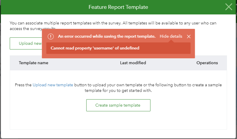

After logged in to Survey123 web designer I am trying to generate Feature Report Templates from Data tab.
I am getting error "Cannot read property 'username' of undefined"
I can see username in question type in app but couldn't generate the Feature Report Templates e.g. Create sample template using Survey123 Web designer.

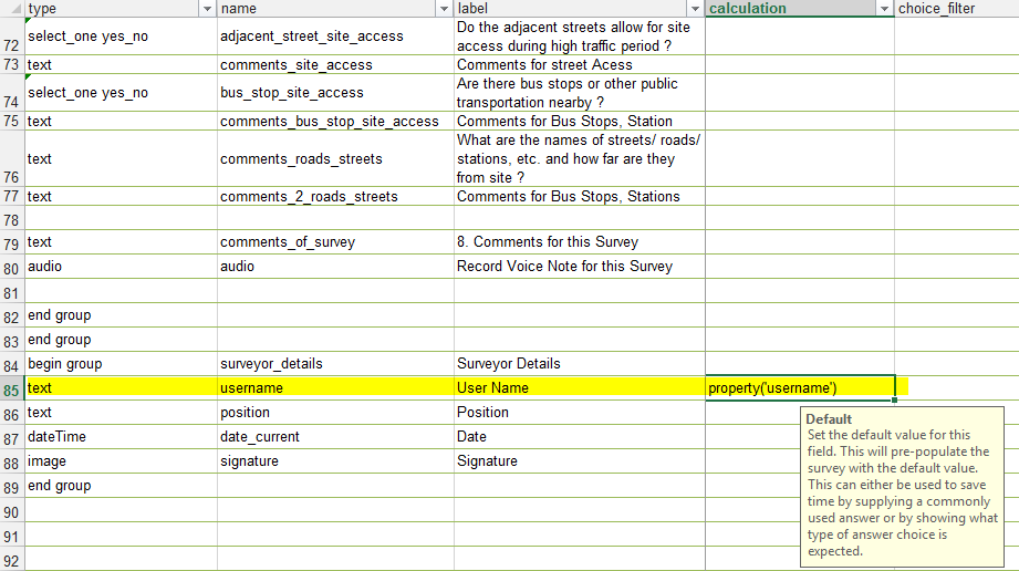

Below is the error :
XLSForm in Calculation field I have property('username) function.

I am unable to reproduce this when using a survey with property('username') in the calculation column.  Having said that, I was testing in ArcGIS Online.  It looks like you are in an Enterprise environment?  Can you please provide more information related to the version and any other details related to your environment?
Also, if possible, please provide your XLSForm by uploading to this thread or sending it to me at [email protected]

Can you confirm there is a field named 'username' in you table (I can see a field whose alias appears to be user_name)?
