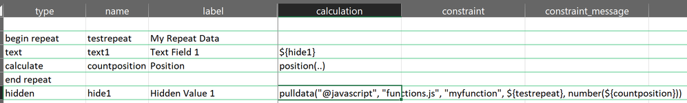

@MSmith1 Threw something together to test this, seems to do what you're needing. Good luck!
function myfunction(testrepeat, position) {
	if (position > 1){
		return testrepeat[position - 2].text1;

Thanks for this @codergrl .  How can I have it pass in the field I want so that the function is more generic.  I am not getting it.
function sameaslast(repeat, position, fieldname) {
if (position > 1){
return repeat[position - 2].fieldname;
pulldata("@javascript", "functions.js", "sameaslast", ${LPIDetail}, number(${RecCount}), "TopCanopy")
If I hard code it works  return repeat[position - 2].TopCanopy;
this does not work  return repeat[position - 2].[fieldname];

Opps forgot to take the dot out.  It now works.
if (position > 1){
return repeat[position - 2][fieldname];

Try this:
return eval("testrepeat[position - 2]." + fieldname);
DougBrowning
MVP Esteemed Contributor
Thanks I jus forgot to take out the dot.   return repeat[position - 2][fieldname]; works fine.
