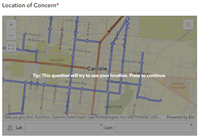

The following are the settings on the geopoint:
  • appearance: press-to-locate
  • default: null
  • constraint: pulldata("@layer", "getRecordAt", "https....", ${location}) (appears as blue outline polygon on the map)

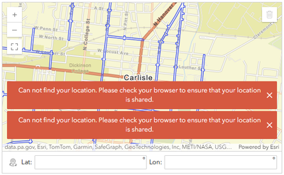

Despite these settings, the map attempts to detect the location of the device.
Gives more error messages when it shouldn't.
Then when I try to click within the blue line to drop a point, this is what happens.
