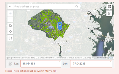

Hi @ZacharySutherby, thanks for this solution. I have been using it in some of my forms. I am using the exact same methodology as you, but I'm finding that the constraint text is still showing up even if the constraint is fulfilled. See example below - the point is in Maryland but you can see the red text. Note this happens occasionally. When this happens, it does not prevent submitting the form, but can cause confusion for our users which we do not want. Do you have any suggestions?
Initially I was using the USA census states layer but switched to generalized boundaries layer as yours used. I thought that resolved the issue (i.e., attribute comparison processed more quickly) but I'm still seeing the constraint text remain.
