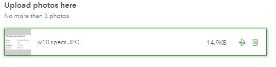

An image question in a survey with an appearance of multiline with a constraint of count-selected(${investigation_photos})<4, does not provide the ability to add more than one photo on the web form.
Works in Connect and in the field app.
I followed the example in this post
When I removed the constraint the web form allowed more than one photo.
Is this a bug?
ZhifangWang
@MikeOnzay ,
Using . (period) instead of the question name to reference the image question itself would be a workaround, such as count-selected(.)<4 .
Please let us know if your use case needs to reference another question other than the image question itself.

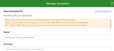

Hola me podrian ayudar estoy tratando de crear un reporte en survey, que lleva 1 mapa y una firma como adjunto. cuando creo el reporte me sale este error.
Error: An error occurred when checking the report template. Failed to parse ${API_13212_FRM_FEC_Encuesta_C1_point | size:400:300} since field name or parameter API_13212_FRM_FEC_Encuesta_C1_point cannot be found in the current parsing scope.
adjunto la plantilla por si alguien me puede ayudar. gracias

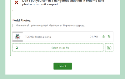

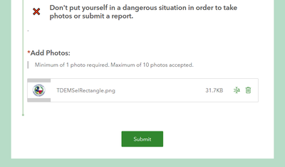

I'm seeing this issue again now in the web app, where the Count-Selected constraint on a multiline image does not allow for multiple attachments. I'm using the most current version of S123 Connect, have republished the survey since the 3.13 update, and do not have the survey's web app version locked. I've tested with and without the required setting and in multiple browsers.
With Constraint:
Without Constraint:
The workaround outlined above still works, but wanted to point this out nonetheless. Let me know if I need to submit a new bug or if the old one can be reopened. (Unrelated....emojis don't always work well in replies in GeoNet 😊🤷‍)
