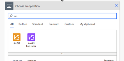

EDIT: Check out @ChristopherCounsell's post below as he gives some very good info/tips. My post just shows how you'd do this in Power Automate.
Short answer is "yes".
You can use Power Automate and the new Esri connectors (one each for AGO and Enterprise). You can specify a WHERE clause to get the older reports and delete them. The flow itself can run on a schedule:
TIP: When working with Esri's connectors in Power Automate, first search for "Esri" > select your workspace (i.e., AGO or Enterprise) > then locate your desired action
Trying to search for a specific Esri Action (e.g., Get data from feature layer) first will not result in the desired outcome since for whatever reason "Get geometry from feature layer" is the only thing that shows up otherwise.
