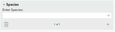

Assuming you are using Connect, it's as simple as creating a repeat, adding your content to the repeat, and publishing!
Here is a quick Example. With these three lines, I can effectively add unlimited species to a survey.

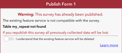

A word of warning so you aren't surprised: adding a repeat to a survey that has already been published will result in the database being erased. This is normal behaviour. Other tasks that result in this are changes to bind::esri:fieldLength and type (e.g., changing Integer to Text).

Thanks!! This solved my problem and worked great!
