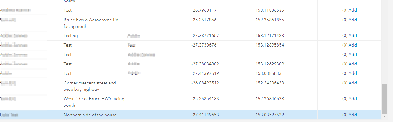

Hello,
We are having problems when using Survey123 in browser and submitting a photo. Photo does not get saved to the feature service.
If we use the app, no issues, photo gets saved and can be viewed.
The survey in Portal, version 10.8.1. Googling did not show any similar errors or bugs. The survey is publicly share for simplicity of use, so browser might be preferred option (as no need to download the app).
Image below is the data view of the feature service that survey uses. Some attachments are no there (shows as zero), however survey has photo as a compulsory field.
RosemaryHatch
I ran into this issue a few weeks ago - it seems like it happens if the user isn't logged in to portal. To get around it I had to go into the settings on the feature layer and allow Update Attributes and geometry.
There may be a better way, it was just a rushed project that needed to be fixed that day.
lxd
thanks for your reply. We had only "add" in the settings for the feature layer. I have updated it now to include "Update" as well and now it works.
