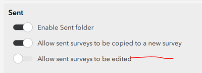

I also noticed 3.14 is now defaulting to allow sent editing to off.  Check that.  Of course should be all devices but maybe.  In Connect then Options.
Edit yep this one got me today.  Did the defaults change on us?  Have not noticed this until now.  Maybe 123 can add here.

Is this menu in the app or in the web designer?
DougBrowning
MVP Esteemed Contributor
Connect, not sure on web.
RobbHodges
Unfortuntaley, the web designer doesn't have that setting. From what I understand from the tech we dealt with, connect is still working as intended.
