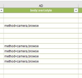

Hi @Anonymous User,
Yes this is expected with the 3.14 update. The default behavior for annotate image questions is to use the camera when it first opens (as per XLSForm specification), and then by using the method parameters you can customize which options are available to the user. Refer to Image section here for more info and supported parameters:
https://doc.arcgis.com/en/survey123/desktop/create-surveys/xlsformsappearance.htm#ESRI_SECTION1_792A...
Regards,
Phil.

Fixed! Add per below in survey123 connect xlsx.
