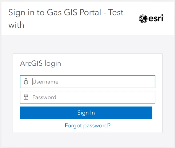

Today I tried to test the user's Survey123 with the test portal, then realized I can't add the test portal to the user's Survey123. When I add the test portal, the portal name should be "Test Portal" but in his Survey123, it's "ArcGIS Enterprise (https://.....the test portal URL...), and when I tried to sign in to the test portal, it leads to ArcGIS Online login.
Are these two separate problems? Or the forms can't pull data because of the portal connection?

Hi @YukoYokozawa,
From your screenshot the login screen is the Portal login page, it is not ArcGIS Online. Based on the Sign In text at the top it is trying to connect to "Gas GIS Portal- Test".

For the test portal problem, the login doesn't work with our username and password for the portal. I'll find users tomorrow and test it again to see if the portal login works or not.
