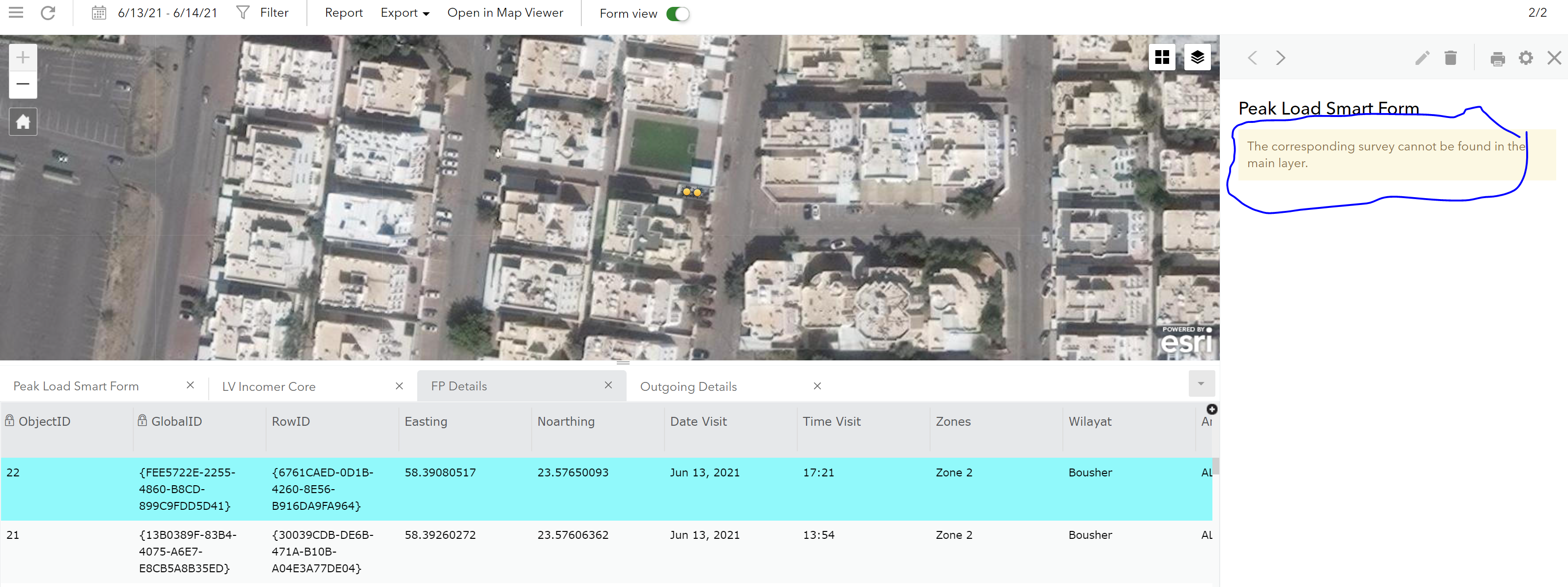

Hi Fellas.
I can't understand why the nested repeats responses don't deleted once I delete their parents rows in the survey123 website. Also, I can't delete them manually from the related table.
the only way I  can delete them by using Pro.
Any advise?
using ArcGIS Enterprise 10.8.1
