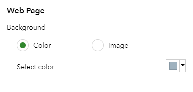

Thanks for pointing that out! I was looking to change that default light green webpage background color from a connect published survey (still isn't possible in connect) and that's one of the changeable options in the web designer:

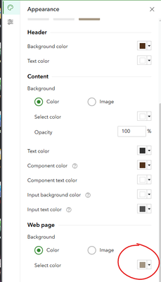

Is there still not a solution for this? I just want to change the web page background from that green it defaults to.
ChelseaRozek
MVP Regular Contributor
I'm able to change it in the web designer (even though it's published from Connect). Change it down here and then click Published and then Publish in the top right corner. Then it saved the new color for me.
