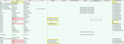

@DougBrowning , thanks. Glad to know I'm not crazy at least. The only other thought I've had is that in my case I'll be launching Survey123 from Field Maps and thus can pass the attributes in question from Field Maps to Survey123 via URL. So I'm thinking I can create some temporary hidden fields (with null schema), load the attributes into the temp schema from the URL, and the calc the values into my field schema within the various repeats (thus avoiding using a duplicated field name within a calc, since the temp field name is unique). I haven't tried it yet, but think it should work...

PaulPetersen1
It seems that I can duplicate a field name in the form, as long as I don't reference that field name in calculations, defaults, relevant, etc. It highlights the field in pink, but doesn't actually stop me from publishing and collecting successfully. My prototype setup is in the screenshot below. Basically I write values to a null-bound temporary field and then use the temporary field to calculate the duplicate fields. It works in my testing so far...the method allows me to write the same value to duplicate field names within the form.

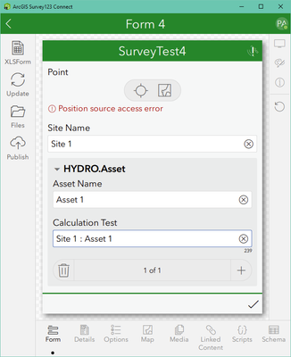

Luckily, there is an alternative syntax for referencing questions in calculations that identifies them unambiguously, even if the questions have the same name: you can specify a path to the question. Our contact shared this doc which explains it in more detail. In a simple example, consider a survey with:
  • One question in the main section called "Name"
  • One question in a repeat section called "Name"
  • A calculation in the repeat section that concatenates the values of those two questions
Observe that the calculation uses path names to reference the two questions:
/Form_4/Name
/Form_4/HYDRO.Asset/Name
where:
  • "Form 4" is the name of the survey / Excel workbook
  • The leading part of the path for both questions is "Form_4", with an underscore instead of a space
  • The name of the repeat section, "HYDRO.Asset", is included in the path to its question
Testing the survey in Survey123 Connect shows that the "Calculation Test" question correctly concatenates the two name values:
