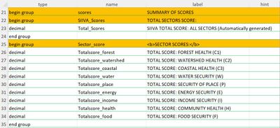

Reuben
hi Laurence,
So this situation is that, I want to automatically generate the Average scores of 9 items.
The scores for each of  the 9 items was calculated from the survey itself. I want to add-up those scores
and get the average score of the 9 items. This is my automated formular:
(${Score_item1} + ..... + ${Score_item9}) div 9. It work only when all the 9 items' score are available.
If I only have the scores of 8 items instead of 9, this formular would not generate the average score.
This is the Excel arrangement of my Survey:
Hope its clear
LaurenceTait
Oh, well that's easy.
Write a formula to convert each answer to 1 if it has been answered, and 0 if it hasn't. Add the result. that gives you the number of answered questions.
Sum the answer for each question. Divide A by B.
Note that this requires that you set the default of each answer to "0". You can't sum a null field. If there is a reason that you can't set the default to null, you will need to use a variant of the formula used to calculate how many questions have been answered :
(if(${score_1} > 0, ${score_1} , 0))  + (if(${score_2} > 0, ${score_2} , 0)) ......
Reuben
hi Laurence,
Thanks alot. This helps
