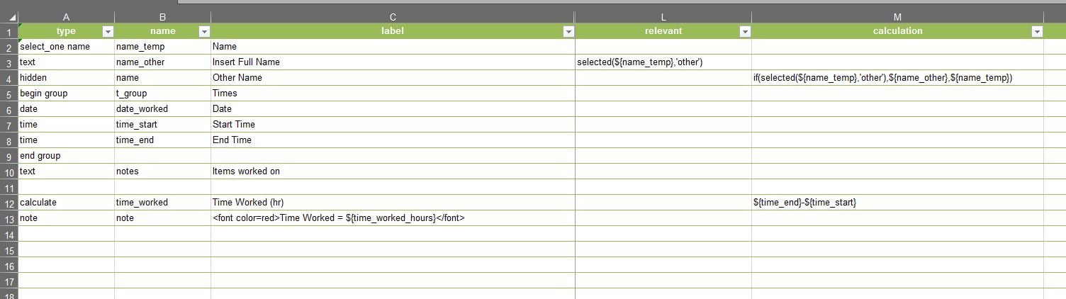

I am trying to wrap my head around calculating hours between two TIME fields. There are alot of blog posts around this, but none that I have found that give me hours worked in this format:
Start Time = 10am
Finish Time = 2.30pm
Calculation == 4.5
I have the below excel document, can someone please tell me how to get the result I am looking form?
I know this is a simple one but I can't get it!
See row 12 & 13 below

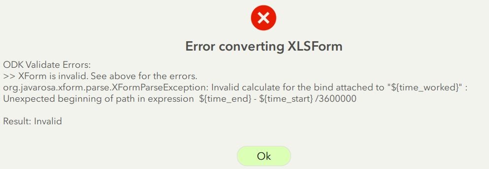

I try doing ${time_end}-${time_start}/3600000 but I get this error:
Note: I know there is a reference error on line 13 in the screenshot, it has been resolved, it is unrelated to this question

The trick is to convert the time questions to decimal time. So your calculation would look something like:
round((decimal-time(${time_end}) - decimal-time(${time_start})) * 24,1)
Note that the web app supports decimal time only, while the field app supports Epoch time and decimal time. This Help topic gives a good comparison of the two storage methods: Decimal date time—Survey123 for ArcGIS | Documentation
And this blog post covers all the ins and outs of working with dates and times: https://community.esri.com/groups/survey123/blog/2016/04/17/dates-and-time-in-survey123-for-arcgis
As mentioned in the blog, there's a handy Dates & Time sample survey available in Connect which has plenty of good examples. Also see the comments in the blog post regarding issues with rounding.
Hope this helps
