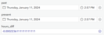

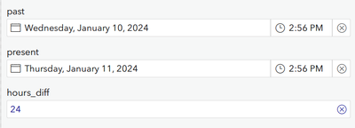

Regarding the time difference, I'm not sure I understand. Do you just want the number of hours between two dates? That is relatively simple:
You will want some type of rounding on this otherwise you will end up with a very small decimal due to the slight differences in time. E.g.:
