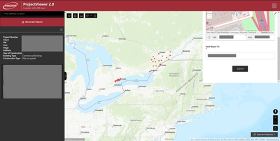

I've been looking at a around where a user can submit a survey off the feature, enter their email, and this creates a web-hook based request to generate a report from one or more features and then email it. Not ideal, as I'd rather it execute as a request within the web app (like it does in the Survey123 website) but it should give a lot of options.

I actually had a need for this come up last Friday. I have been poking at a few things, and I think I have settled on a super low-effort fix for now. In my case, I don't just need a Feature Report, I need some other documents generated as well, which means I need Power Automate to be invoked. I was going to jump through a bunch of hoops (and may still), but I decided "why don't I just make a simple survey based on the Feature Layer?" That way, I can use pre-existing webhooks. I need to clean a few things up, but this will do what I need it to without the need for any custom script.
