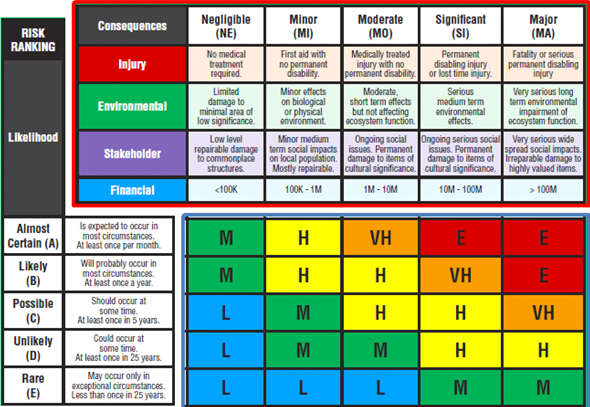

Hi in my survey I have two 'select one' list questions based on Likelihood (Certain to Rare) and Consequence(Negligible to Major). I'd like a message to popup with the resultant Risk Level based from the selection of these two fields. i.e. If Unlikely and Minor is selected, I want a popup to say Moderate Risk.

I have done this by using numbers as the choice names (first table) then using formulas in the relevant collumn to display the relevant risk 'notes'
I have only 4 risk class but should work with 5?
