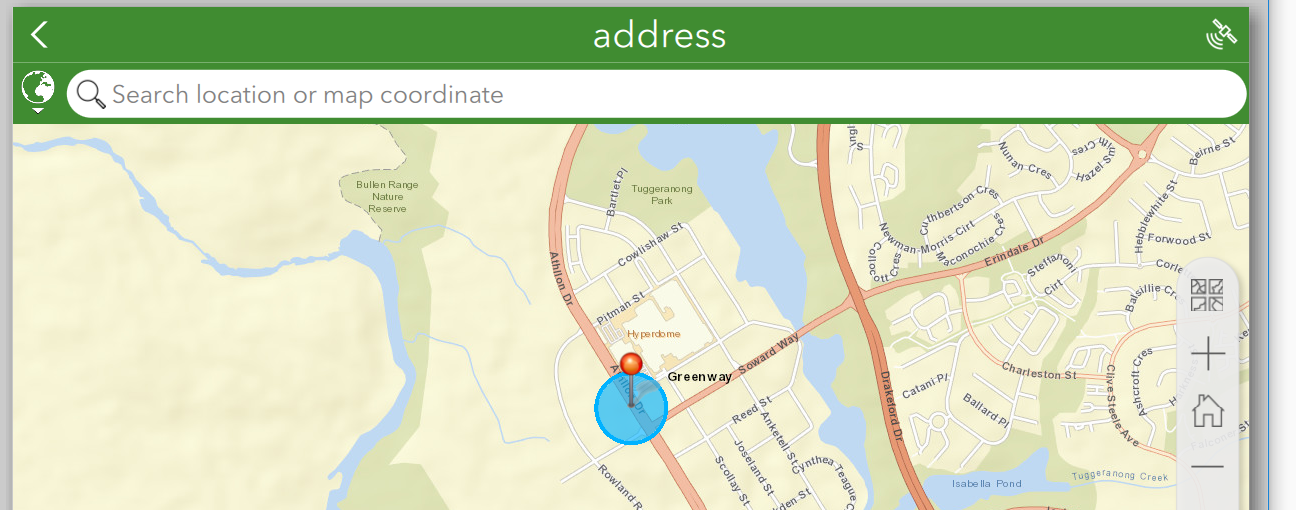

If you use a geopoint you can click on the Map icon and then enter an address:

I know there is the function to find geo point with address on the survey map. But our survey already have address fields. Is there a way to geocode the address fields to get the geopoint on the map automatically? Thanks!
