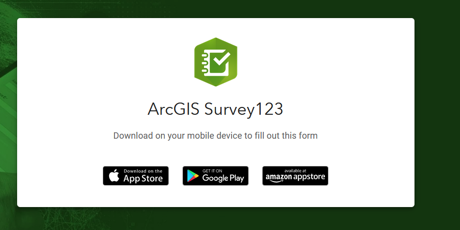

Looks like the website was updated recently. I can no longer open surveys in the Field App via the provided URLs:
Clicking on a URL forwards to this page now:
This is pretty serious for my environment, so I thought that it would be prudent to speak with Esri ASAP. A case has been opened and is currently being looked at, so if this is a bug, it should hopefully be escalated quickly.

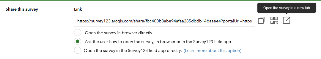

Plus a second work-around:
EDIT:
Just wanted to add this to help give context why the above work-around it's a good solution for everyone. The real issue is how you are delivering links to users. I have links stored in SharePoint and in custom QR codes. In both cases, Esri's custom URI (arcgis-surveys123) is not recognized by these applications. If it doesn't start with HTTP/HTTPS, then it isn't considered a link and thus won't work. See below from SharePoint:
