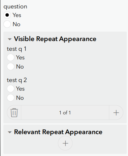

TylerGraham2
I use visible sometimes because it affects how the survey appears. If you use relevant, you have an extra step in the form by having to click the + to start the first repeat.  If you use visible, the questions are visible as soon as the condition is met, and you only need to hit the + for additional ones beyond the first.
FarzanehAhmadikordasiyabi
Thanks, do you know why when I use the visible, the lines are shown for the whole survey not just for the more than 10 locations? Because of the users of this form I prefer using visible rather than relevant
