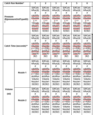

No luck. This is in a repeat table - see photo. If there are only 3 catch runs entered (for ex.) i want all the rest of the boxes filled with a "\" or "-" . I have tried ${ if catchRunNumber !=1} / ${/} but then i get / / / in my report.  If you can guide me how to format this repeat table to only show values entered that would be great too but based on my findings, this is not possible.

I've attached a screenshot of how I iterate through a repeat table that I use for stratigraphy recorded in the field. I call the repeat ${#Stragiraphy} in the first column of the table layout all the fields I need and close the repeat inside the table with the ${/} after "multiline". This creates a seamless table that iterates through all the related repeats.  If you don't have to follow a standard for how your data is presented you might explore reformatting how it is laid out.
If you have to maintain the formatting, you might try $feature | getValue: "position" as a query.  I attached a mock up docx of how I'd try to get it done while maintaining the formatting. I haven't tested this, so it may or may not work. I also reduced the number of times you call the repeat table, rather than opening and closing the repeat for each cell, I call it for a row in your report table and close it at the end.
