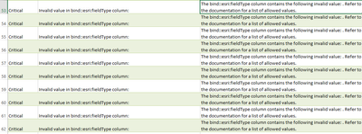

When I analyze my survey, I receive 100 warnnings: LydiaYoungblood_0-1685366838890.pngLydiaYoungblood_0-1685366838890.png
however, my column bind::esri:fieldType looks like this.
Empty. What's going on here?

Hey there,
If you're able to send a copy of your XLSForm, that would be ideal to help support you in this.
My guess is that a blank value (e.g., a space) got pasted throughout the bind::esri:fieldType column so even though there's no data there, there's something other than Null which is causing the issues.
One thing you could try is copying the value from a guaranteed blank cell (e.g., cell AZ2 - something outside of the main table), then paste that in the first affected cell in the bind::esri:fieldType column (I'm guessing T2?). Then paste that cell down to all affected ones and analyze again.

AnnaScholl
Thank you! worked like a charm. Just one clarification-- if I did change it to 'null,' wouldn't that mean that then the data would not be recorded?
Vinzafy
That's correct! Though the field would be usable in the survey, any data for that field wouldn't be stored in your hosted feature layer.

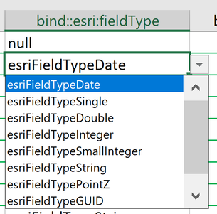

Nicole_Ueberschär
Normally you should have a dropdown option in that column that shows you what are expected (and acceptable) values:
The list is also available and you could re-reference it from the Field Types sheet in your xlsx file.
ZacharySutherby
Hello @AnnaScholl
I believe @Vinzafy is correct it's likely that there is a blank value in the cells that is being reported as an empty string as opposed to truly not having a value in the cell. This will be fixed in the 3.18 release of Survey123 Connect.
In the meantime you should be able to use the XLSForm Upgrade tool to refresh the XLSForm using the 3.17 template and rerun the analyze survey tool.
Thank you,
Zach
AnnaScholl
Thanks! @Vinzafy was correct. I do have to say the Upgrade tool kind of scares me...
