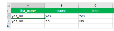

Survey123Jedi
I love this thread, and I'd love to sit down and do a brain dump.
Here's a simple change -
I always tell newbies, "this will change your life" change the yes - Yes (below) to both uppercase because sometimes you need to be coded to the name and sometimes to the label, and this tiny step will save your sanity.
AND I'd share that you should do this anytime you can.
I hope this changes your life too.
~Michelle Survey123 Jedi!
ThomasHamill
Yes, thanks!  I do this too!  Definitely another essential—keeping names and labels (domain code and domain description) the same for the single-word entries.
