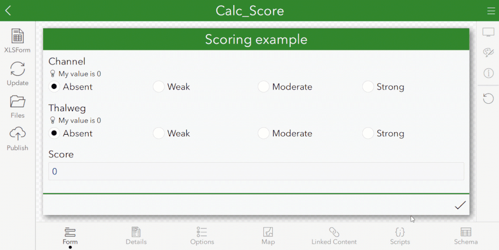

To add more to @DougBrowning 's answer, here is a simple XLSForm that hopefully gives you some ideas.
Note that:
  • When you create a list, you can assign a number to the value of a choice. For example: In the grade choice list, the value of the label Absent can be set to 0. In this way, when the user selects Absent, the value of the question is set to 0.
  • If you do the above, you may want to set the bind::esri:fieldType column to esriFieldTypeSingle. In this way, the selections of your choice list will be stored as a number in ArcGIS
  • You can then use a calculation to get the score.
    • ${channel} + ${thalweg} : This is the simplest syntax, but will return a null value if any of the input values is null. This is because: 1 + 0 = 1 but 1 + null = null    If you use this syntax, you will want to make sure all your input questions are required
    • coalesce(${channel},0) + coalesce(${thalweg},0) is safer. The coalesce function takes two values and returns the first value that is not null.  With this, your sum will get you back a number even if one the questions has not been answered.
Check the attached XLSFile for details
Note that:
