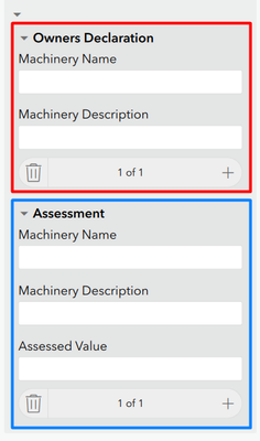

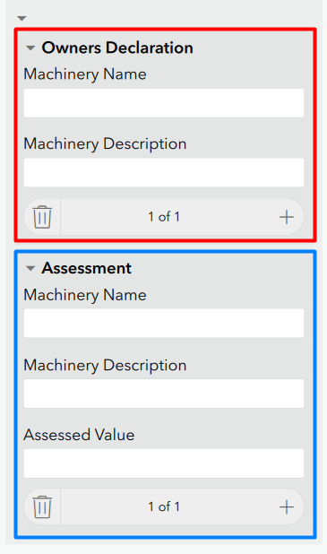

For instance, I have here 2 Repeat Question Types: Owners Declaration and Assessment. Please see the reference image below.

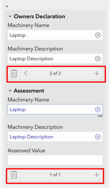

What I want to do is, I want to autopopulate the Machinery Name and Machinery Description fields in Assessment Repeat using the values from Owners Declaration Repeat. Yes, I can call/reference the fields in the calculation. However, I am having issues for multiple records in Owner Declaration Repeat. It does not properly/correspondingly autopopulate the Assessment Repeat. It just autopopulates the first "page" of the Assessment Repeat. Please see reference image below. I have 2 records in Owners Declaration Repeat but in Assessment Repeat, only 1 record is autopopulated. It seems that it only autopopulates what is currently displayed.
