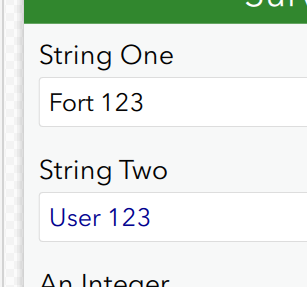

 But honestly, it seems more like you're just replacing "Fort" with "User". If these are both string fields, you could try something like this instead:
concat('User', substr(${installation}, 4, 0))
That way even if the Fort choices expand to larger numbers, it will still work.
