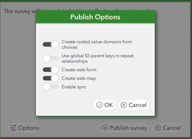

In Survey123 Connect, I have created a short survey and published it to my Portal. During publishing I selected Options > Create Web Form.

I found the root cause was that my survey name in Connect contained spaces. If I save as with a new name, replace the spaces with underscores, the issue is resolved and I can now open the survey in a web browser.
