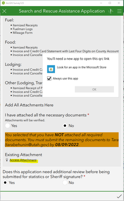

@ZacharySutherby Thanks so much for your response! I am not very experienced with javascript so I'm unfortunately still having some issues:
I have copied the code and survey fields over, and I am able to publish -- but when I go into the field app and try to click "Access Attachment" it says I'll need a new app to open the qrc link. I'm guessing (I could be completely wrong) that it has something to do with the URL and the id field that I swapped to. I don't have inc_id so instead I used my case_number field which is a text field with no restrictions. I swapped inc_id in line 15 (let where = "where=inc_id="+"'"+incid+"'";) to case_number, and I swapped the layerURL for my feature layer. Another thing that may be weird is that my survey has a submission URL which is pointing at a view layer of another hosted feature layer (which was created by a survey) -- not sure if that would affect anything.

GIS_utahDEM
@ZacharySutherby Yes, I was able to swap both URLs.
I am including a screenshot of what I see when I click the "Access Attachment" link. I am unable to right click it or inspect in any other way as far as I can tell.

ZacharySutherby
Hello @GIS_utahDEM
If you switch the query_attach question from a calculate to a note or text question when you are in the Inbox does that display a URL?
