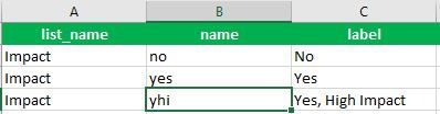

We are trying to create a survey in Survey123 Connect where a score is assigned based on user choice for a select_one type question in an integer type following the question. The issue we are having is that we are only to generate scores for 2 of the questions depending on the calculation formatting. See screenshots below as well as the calculation used in the integer type. Any suggestions would be greatly appreciated
if(${a2o_1}="yes",${c2},${c1}) or if(${a2o_1}="yhi",${c3},${c1}) or if(${a2o_1}='no',${c1},${c1})

You cannot use or inbetween if statements like that.  You need to use the else in the if.  Looking at your options I think this would work and be simpler.
if(${a2o_1}="yes",${c2}, if(${a2o_1}="yhi", ${c3}, ${c1}))
This assumes it will never be blank.
Hope that helps
