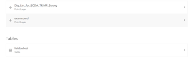

Hi,
I have a survey123 form that contains a repeat for survey data, within each repeat is a nested repeat that collects 2 sets of GPS x,y coordinates.  So this creates 3 separate items in Portal,  two layers and a stand alone table.  Is there a way to leverage arcade expressions in a web map to join (in my example below) the
examcoord (parentrowid) the fieldcollect table (uniquerowid)?  I dont want to have to join them manually each time a survey is collected.
I intend on using a dashboard to provide an end-user product that will provide a map and details for each survey.
Lastly, the 1st point layer Dig_List_for_ECDA_TRIMP_Survey captures information for each survey but it is collected outside of all repeats.  Is there a way to join this table information to the other point feature?

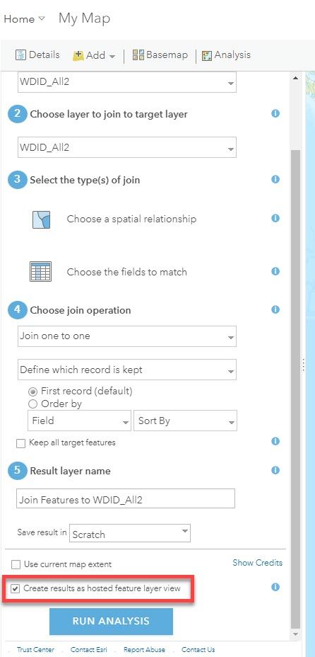

JenniferAcunto
Join is available in the Web Map Viewer Classic. If you check Create results as hosted feature layer view a view layer will be created that updates the join automatically as data is added to the layer.
Creating results as a hosted feature layer view allows the data to stay up to date as the source data changes. Hosted feature layer views containing joins will be read-only.
Hosted feature layer views containing joins do not consume credits for analysis and storage.
You can create a hosted feature layer view from the analysis results if all of the following conditions are met:
  • You are the owner of both layers.
  • Both layers are hosted feature layers.
  • You are performing an attribute join.
Join Features
- Jen
