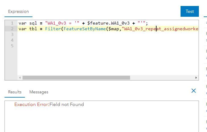

survey123_solutions
Hi Doug,

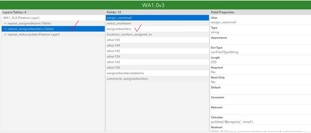

Thank you SO much for your insight.  I gave it a shot and still getting execution error.  Something in my code is off.   If you would take a quick look.  Below is a glimpse of the schema - thanks so much.
var sql = "WA1_0v3 = '" + $feature.WA1_0v3 + "'";
var tbl = Filter(FeatureSetByName($map,"WA1_0v3_repeat_assignedworkers", ['assignedeworkers'], false), sql);
DougBrowning
MVP Esteemed Contributor
Looks like a typo on the field name  'assignedeworkers'  you have a e in the middle here.
Oh and you will prob need the field you are going to filter on.  Looks like WA1_0v3?
