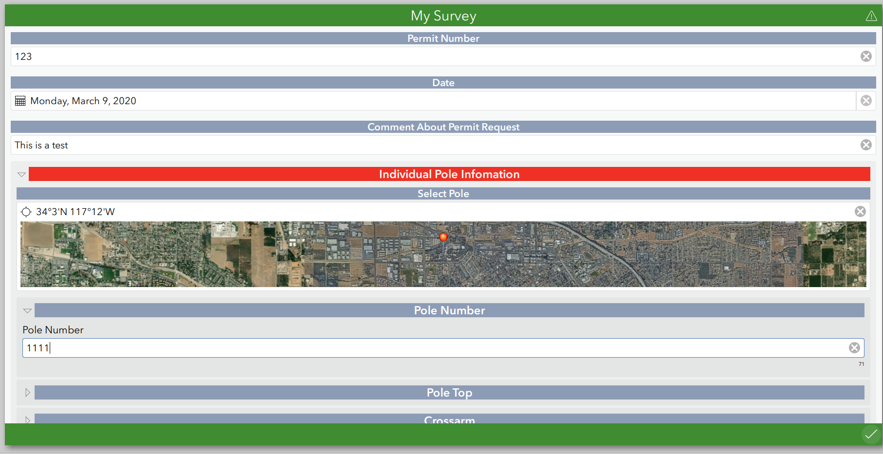

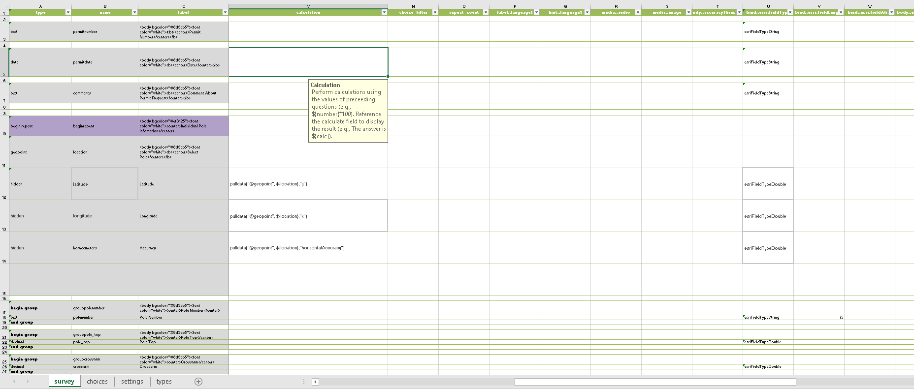

I have not found any post relating to this, so I figured I would post a question about this topic. Is it possible to populate repeats from existing points in the collector app? For context, I have a a feature class that has poles with pole numbers. I am attempting to create a survey that allows users to create attachment requests for multiple poles under the same permit number. This is the CSV that I have created
I am trying to use the following URL to populate the pole number and pole location within the Repeat group.
arcgis-survey123://?itemID=<the survey id>&field:polenumber={wmElementName}&center={wmYCoordinate},{wmXCoordinate}
But it will not populate in the repeat.
In a perfect world, I would like for the individual to hop into the Collector app, select multiple poles, click the URL link, have that open up in Survey123 with a repeat for the number of poles that were selected (so if they selected 4 poles, 4 repeats would be created) and populate the repeats with the geometry of each pole and the pole numbers of each selected pole.
Any help with this would be greatly appreciated.

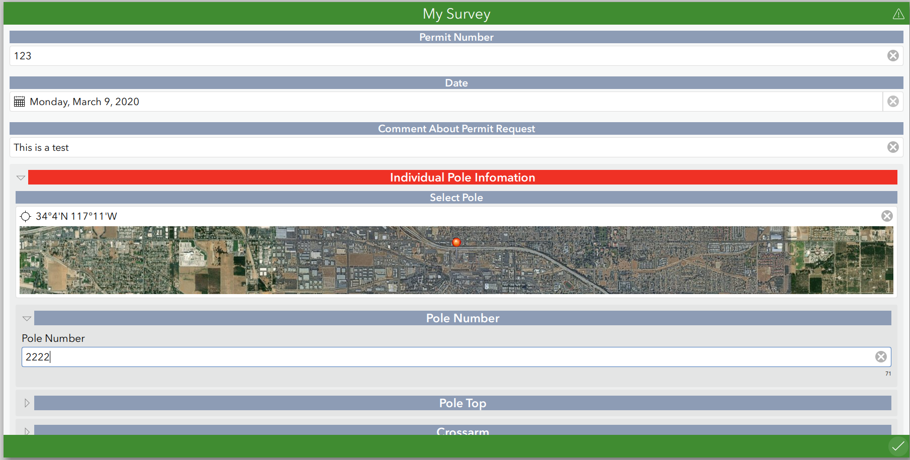

Below is an example of what I would want to auto populate in Survey123 when the URL in Collector is clicked.
Repeat 1...first pole location and pole number
Repeat 2...second pole location and pole number
...etc.
