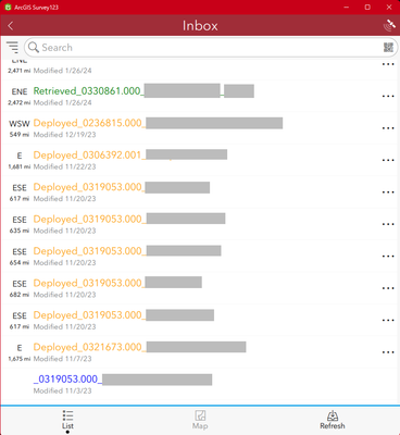

As a follow up, if you want to simply draw attention to specific line items in the inbox, you can use text color like you said.
This is what I use for one of our sampling forms' Inbox:
if(${prime_stage}='Deployed',concat("<font color='Orange'>",${prime_stage},'_',${gn_pn},'_',${meta_loc_address},'_',${gn_client},"</font>"),if(${prime_stage}='Retrieved',concat("<font color='Green'>",${prime_stage},'_',${gn_pn},'_',${meta_loc_address},'_',${gn_client},"</font>"),concat("<font color='Blue'>",${prime_stage},'_',${gn_pn},'_',${meta_loc_address},'_',${gn_client},"</font>")))
The result is a color-coded list of items:
The blue items are "unclaimed items", orange is "deployed" and green is "retrieved". Items are searchable by status, project number, address, and client name and sortable by status or date
