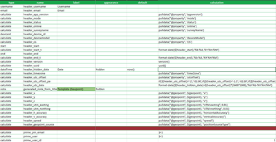

I have the following for all surveys with a geopoint. Non-geopoint sureveys are very similar, but just missing the few geopoint specific line items.
That IF() statement is quite long as it covers NL to BC (so basically NA): if(${header_utc_offset}='-2','-02:00',if(${header_utc_offset}='-2.5','-02:30',if(${header_utc_offset}='-3','-03:00',if(${header_utc_offset}='-3.5','-03:30',if(${header_utc_offset}='-4','-04:00',if(${header_utc_offset}='-5','-05:00',if(${header_utc_offset}='-6','-06:00',if(${header_utc_offset}='-7','-07:00',if(${header_utc_offset}='-8','-08:00',if(${header_utc_offset}='-9','-09:00',if(${header_utc_offset}='-10','-10:00','')))))))))))
All of these items get dumped into a tracking list to I can monitor items from a PBI dashboard. Some of these items are used in 98-100% of my automation processes (e.g., prime_pin_email is where I dump all emails for a form so I can send off various email notifications)

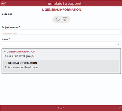

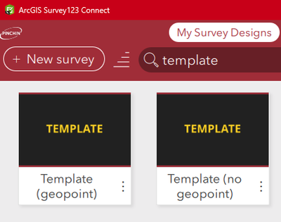

EDIT: These are set up as TEMPLATES, so all forms are these standardized items.
And since I talking about standardized items, I also have example groups and text items in my templates so that all forms have a similar look and feel. I don't want to re-invent the wheel each time. So, for the sake of this thread, I also have these:
(gn_pn is also a standardized field. The vast majority of my forms require a project number)
