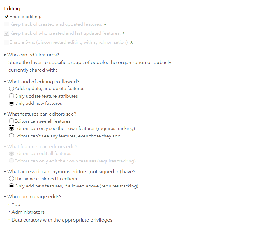

When I create a new survey using the web designer the editing settings for the related ‘fieldworker’ Feature Layer are as below:
If I choose to make the survey public, my interpretation of the above would be that an anonymous user (i.e. one not signed into ArcGIS Online), would be able to add records to my survey, but only view the features they had entered (or not see any features that had been entered, including their own, if that’s how you interpret ‘What access do anonymous editors (not signed in) have?’ when set to ‘Only add new features, if allowed above (requires tracking)’).

In some use cases you can get around this by changing the ‘What features can editors see?’ to ‘Editors can’t see any features, even those they add’, which then stops any user seeing any features.
This approach is fine, but I’ve also noticed that if you republish your survey at any point the settings revert to their default settings (it goes back to ‘Editors can only see their own features (requires tracking)’. Again this isn’t made clear and means you need to re-set your settings each time you publish. This is inconvenient, but more importantly in the time between you publishing and re-setting the edit settings your anonymously entered data are essentially publicly viewable. If you’re not aware of these two issues it can be very easy to make data available publically in a way you had not intended.

For point 2) I'm a little confused.  Are you saying you shouldn't alter the permissions directly on the Feature Layer (as pictured in my original post)?  If so, it goes against the advice given in the blog post here which specifically states this as a method for preventing people from viewing data in public surveys.  That would also suggest that there is no way of preventing anyone accessing anonymously entered records.
